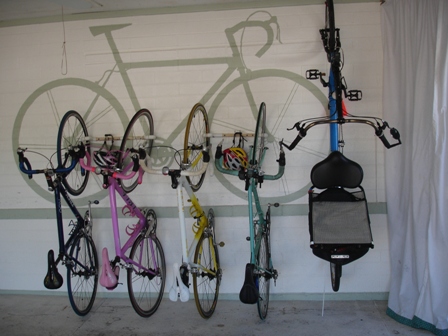

    you all totally inspired me. i made this rack yesterday, and my garage looks so much cleaner!!
    i added two other pictures from my garage just to make the bianchistas and trekkees jealous (DH finds me the coolest birthday gifts!)

    Pink- Please share how you made your rack system. That is exactly what I have in mind for the expanding fleet of bikes in our stable.
    Cool gifts by the way, I want a Cannondale sign.

    Wow, Pink! That looks great. Did you paint the graphic on the wall?
    sunny scottsdale, az
    638
    yeh, i painted it. thank you.
    i built the garage too.

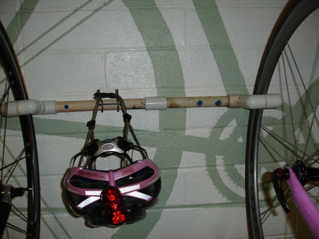

    for the bike rack i didnt do any measurements or anything, just started with old sprinkler parts and started piecing it together, holding the bike against the wall and figuring out rough dimensions. then i dry-fit it together, did some more cutting or replacing pieces that were cut down too much, then when i was happy i glued it all together. i used 3/4" PVC, 90-degree elbows and masonry screws (blue tapcons). oh and old pegboard hangers for the helmets.
