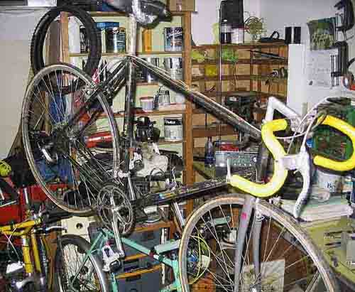

    Here are a couple of pix, hastily taken just now, of my Bianchi Limited converstion. Hope it gives you some ideas! It was my winter project in Dec 05/Jan 06. I took couple of weeks to strip, paint, re-decal, and do the mechanical restoration, then the conversion later in 06.

    Not sure about the bars and stem, I had them in a box of parts in my workshop. They are basically 1" quill mountain bike stem and bars with bar ends. The tires are Continentals marked 700x28, but they actually measure 31mm wide. Yes, they fit right on the original rims. The bike's color now is gloss black, the original color was a kind of brownish~black (as far as I could tell: most of the paint was gone). The pic below shows what she looked like the day I brought her home. Tires rotted, cables seized, anything not alloy was rusted tight.
