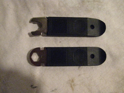

    How about tire levers with 3 spoke wrench sizes and 8,9,10 mm open wrenches? These came with a carry-along chain tool that I have, and they are quite nice. Wish you could buy then alone.
