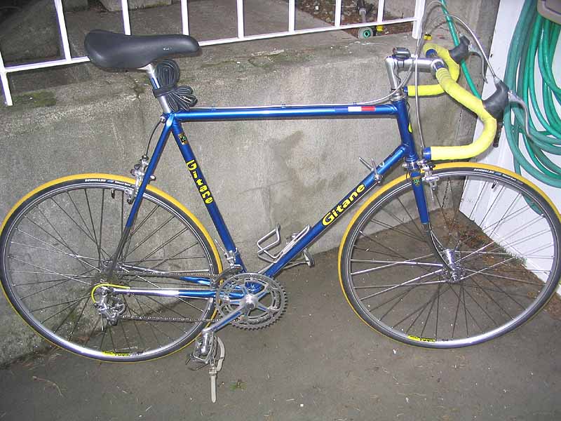

    popoki nui
    what about YOUR bike? I'd like to see THAT.
    Meet "Geri", my early-70's Tour De France. We have been together since August 19, 1977. A more detailed description here.
    (She's my #1 baby. I try not to say that too loud lest my other four bikes become jealous. Sibling rivalry, you know...)
