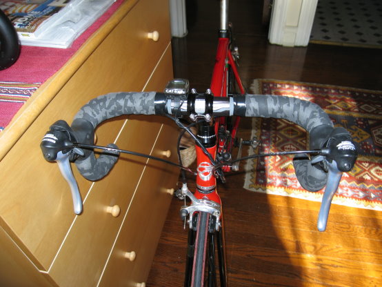

    Thumbs up Update after upgrades
    Just wanted to post an update on the changes and upgrades I did following the advice on this board, instead of upgrading the fork to a carbon fiber one.
    I replaced my Salsa Poco with a Specialized Dolce Ergo bar (with "zertz" inserts), used Specialized's "Super Phat Bar" tape and Bontrager "Bzzzkill Harmonic Dampers." Also, I started to inflate my front tire a bit less than before (rated for 70 to 120 psi, I pump it now to 110psi). I'm happy to report that my ride has improved noticeably. It is not plush by any extent of the imagination, but significantly more comfortable for me. There were two unexpected benefits of these changes: (1) The Specialized handlebar has a shorter drop and reach, so it is easier to spend more time in the drops. (2) Also, my bike is less twitchy now and I am able to pedal off the saddle with more confidence.
    Once again, thanks to all who helped me. I included two pictures of the new cockpit. Below them is the chart regarding tire pressure I referenced in an earlier post in this thread.
