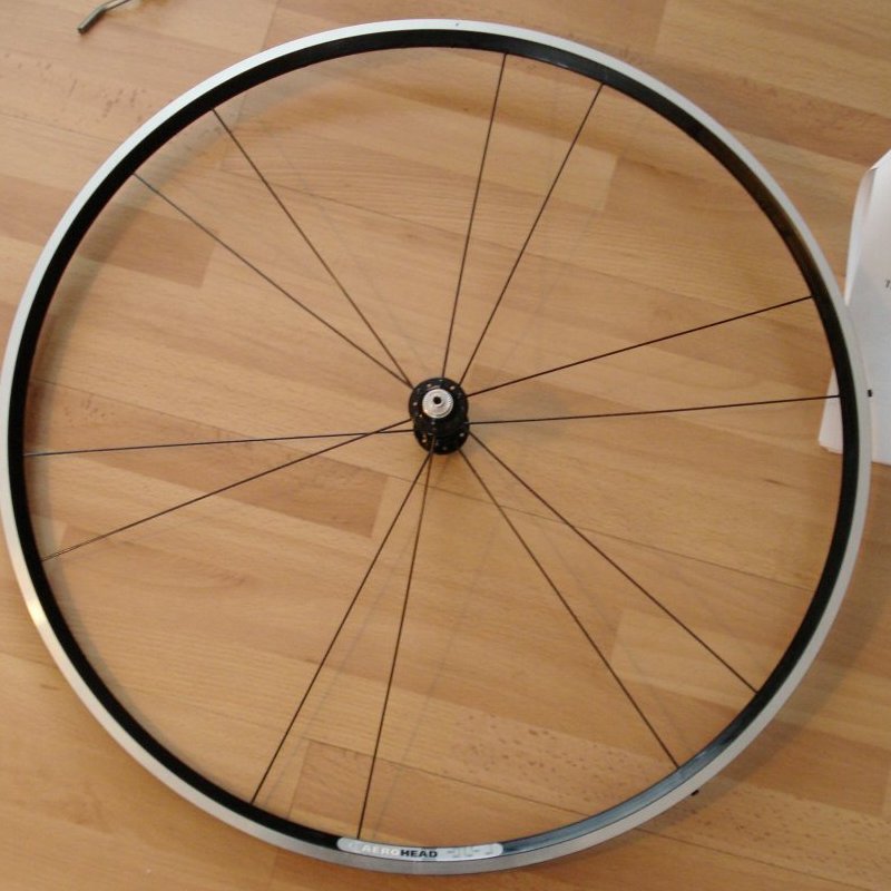

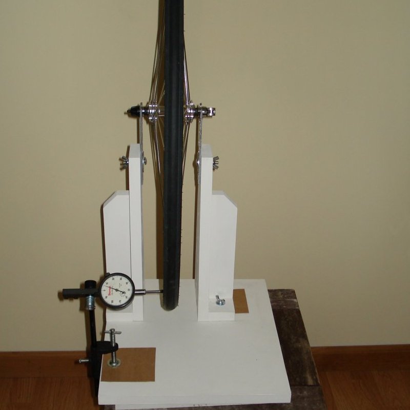

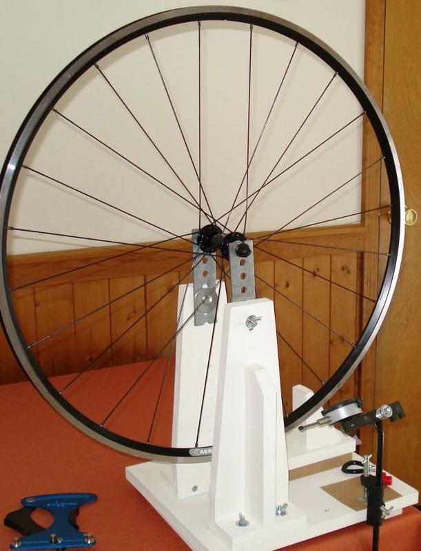

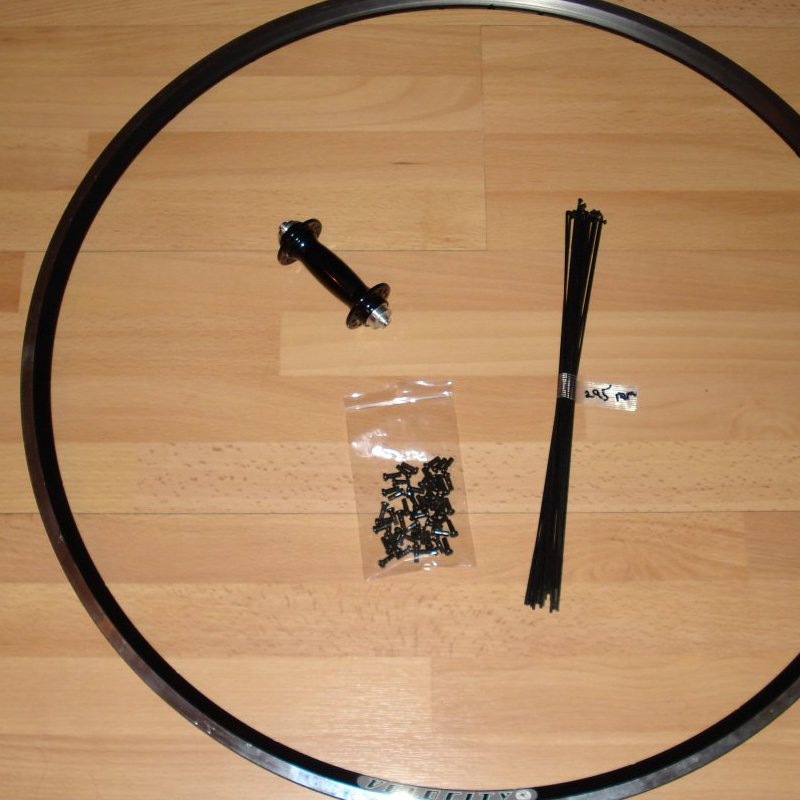

    Finally, one wheel built & pix
    Well, it’s been close to a year since my initial post. Some people had PM’d a while back asking what if anything became of this. I said I went the route of wheelbuilding, it was in progress, and that I’d post pictures when I was done. The front wheel is built. One down, one to go.
    See this link for more detailed pictures and narrative. http://good-times.webshots.com/album/562286905oyplvC
    Remember to scroll down under the picture if you want to read more.
    This whole thing was really fun, especially since I was clueless as of last year’s first post. I did a lot of homework and it took a long time for me to decide which rims and hubs I wanted, naturally dictated by what kind of biking I did and cost. But that was part of the fun. I settled on Velocity Aerohead rims and White Industry H1 hubs with Wheelsmith double butted 2.0/1.7 spokes. I went on a couple of wheelbuilder sites and this combination as I found out halfway through my decision, is a pretty common build. I am using Veloplugs instead of rim tape based on some conversations within links of this thread. I let the project rest through the summer and didn’t order parts until November. I ended up building a homemade truing stand and dish stick (see web link photos) based on Roger Mussen’s Wheelbuilding book. The set up with building a homemade truing stand was intentionally part of the journey and half the fun. To try and come up with homemade tools that will do a sufficient job at zero dollars, and use things I already had. The fun part also was that I didn’t know how that part would play out and I just went along with it as it happened.
    My friends, biking and non-biking, were enthusiastic and so that was fun too. Several of the non-biking friends didn’t understand what I was doing so I just said that I was re-creating the wheel.
    I used Roger M’s and Sheldon’s guides for lacing and truing and dishing, etc. None of that was very difficult. The most important things is to pay attention to what you are doing when you are doing it. I stayed with a traditional cross pattern for my first wheel and kept away from radial spoking or bladed spokes. The 2x pattern is fine as I am not a heavy person. I was able to get lateral truing to 0.25 mm due to an insanely accurate Starrett dial gauge that I borrowed from a friend. That gauge wasn't necessary but I was just curious. I got dish to within 1 mm and radial truing to less than 1 mm, all acceptable tolerances. This is shown all on the weblink. I did invest in a tensionmeter which was essential for me at least, to get the spokes to the proper tension and evenly. I can’t play the harp on spokes like some of these guys can.
    Someone mentioned that the cost of the components basically comprised the cost of the wheel. That’s true. For not much more, I could’ve let a wheelbuilder finish the job but that wasn’t the point.
    Right now they might look good, but I'm very interested if they will hold true after the first 200 miles. That will be the real test of a well-built wheel.
    The next thing I want to do is get a new frameset and build a bike up with the components I want.
    I'm not sure how to place text between the photos so I'll list here:
    1. initial construction of homemade truing stand
    2. truing stand painted and with old wheel
    3. wheel parts
    4. the leading spokes are in
    5. bringing the wheel up to tension

    Wonderful job!! Glad you had fun building, too. You really went all out, reading, learning, building a jig, calibrating tolerances. Now you'll enjoy your wheels in a new way, knowing that they are strong and light and build to your specs and built by you.
