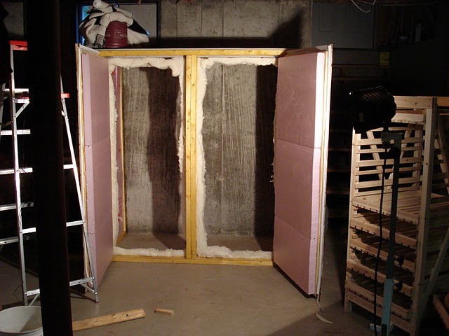

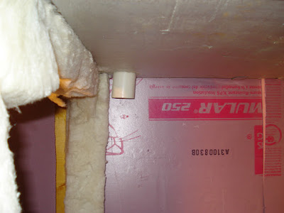

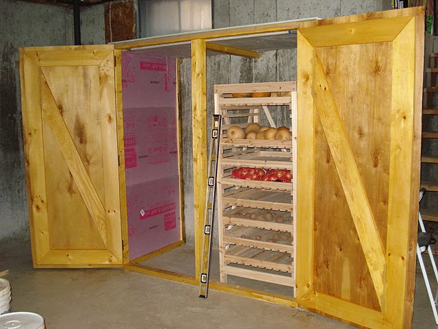

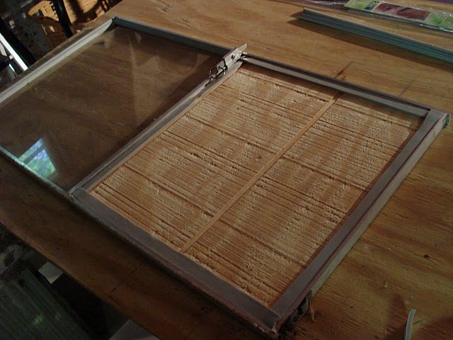

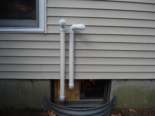

    Well, it's funny how life gets in the way of finishing things. Here's the latest on the root cellar, which has been extremely fun to make. It's so liberating being handy. I would have finished today except I needed a couple more pvc fittings and I wasn't going to make an hour round trip to get them.

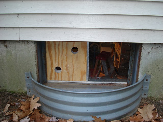

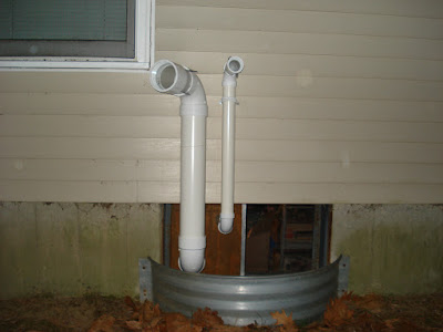

    I finished making the doors which wasn't a standard size at all, and finished insulating them. I began on the air exchanger and was able to easily pull out my basement window and replace one half with plywood and foam insulation. I took my trusty hole saw and made some nice clean holes for the piping to get through. I fit together the pipe on the outside, but I think I will cut them a little shorter. Although, they have to be high enough to be above the snowdrifts. Link to more narrative

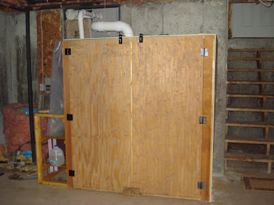

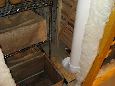

    Well, I've made some adjustments and pretty much finalized the main unit. I don't think I'm going to get to finishing the fruit bin part for a while now. My farm apples have been in the kitchen fridg, although not leaving much room for much else. I need to move on to a couple of other things. I want to expand my grow light shelves to accomodate more seed trays and I want to finish this in January. I also need to finish the insulation up in the attic. Because of this year's tax credit, I'm upping the R value up the attic. I tell you, in theory it's one of the easiest jobs to do, just put insulation in. But it's miserable - walking, crouching in all sorts of contorted positions, banging my head on the slanted roof with roofing nails sticking through, walking like a cat on the floor joists or across placed boards so as not to step wrong and land a foot through the ceiling below requiring drywall repair. I spend a couple hours up there and I come down feeling like I got hit by a truck!

    Here's the link to the complete root cellar process which gives a better explanation of things.
    A couple of pictures:
    Had to change out 2" pipe for 4". The 2" just wasn't sufficient and there was too much of a temperature differential. I couldn't get the root cellar down to temps I wanted. See above link for better explanation.
    Intake pipe all the way to the floor to pull in cold air
    Exhaust pipe on ceiling to remove warm air.
    Final unit
