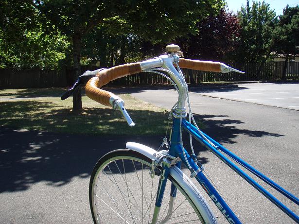

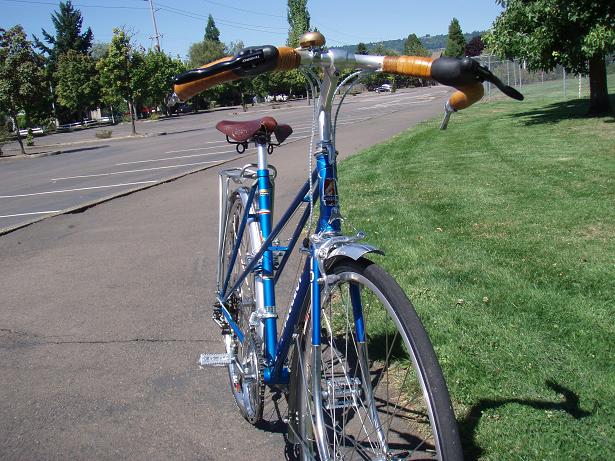

    Here's a picture of the Mixte I fixed up with moustache handlebars. I no longer have the bike, but I loved the look and feel of the handlebars.

    My Surly Cross Check has moustache bars with the same set-up as oxysback.
    I love bar-end shifters (I am not fond of brifters) and find moustache bars to be the perfect bar for me.

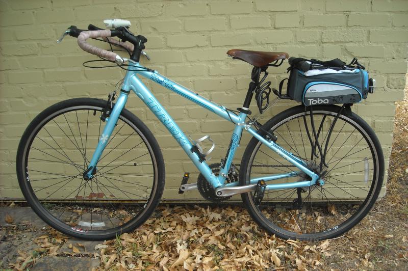

    I have DiaCompe brake levers and Shimano bar ends. I've been very pleased with this set-up.
    The cats have added a nicely textured "non-slip" surface to my bar ends (out of concern for my safety, no doubt).

    It's a Trek 7.2 FX WSD. Utilitarian, but also fun as can be.
    In my old apartment, I used park my bike by leaning it near this big potted plant that I had. The kitties would jump onto the plant and gnaw away on the bar ends. I guess they found them satisfyingly chewy, although I can't fathom why the darn cats ever thought to give them a nibble in the first place.
    ETA: Ew, my bar tape has gotten really gross!
