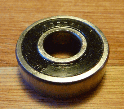

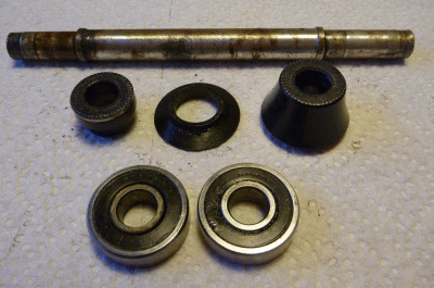

    Oh, sorry. I have no idea how they were taken out, the LBS did it for me and I got the hub back in pieces.
    Here's a picture of the bearing, and of the assorted innards of the hub. I guess the bearing is supposed to be pressed in, there aren't any threads and the side surfaces are smooth. The surface is stamped 6000RS.

    I believe the bearing cartridges get pressed into the hub. If that looks like a good fit and you're sure of the orientation, you could press them in with a long threaded bolt, 2 big washers, and a nut. Lightly grease the outside of the cartridges first to help them slide in.
