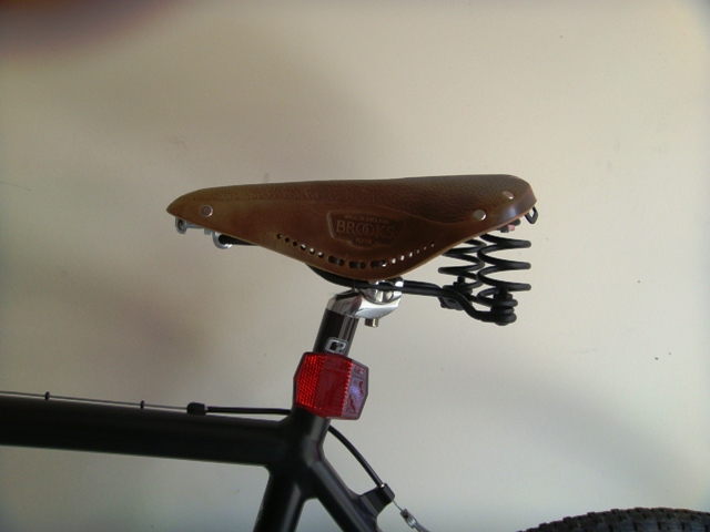

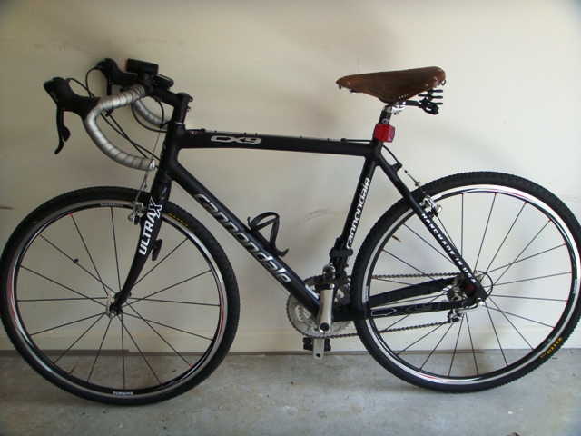

    Well I just received my new Brooks Flyer, Pre-aged today in the mail. I slapped that bad-boy on my bike and off I went for a 10 mile ride through Clifty Falls State Park. My sit-bones didn't hurt at all, but my girly-bitz were not happy! They were ok when I was riding on top my bars, but when I rode down in the drops, they started to hurt. I also feel like i have to keep scooting back in the seat to get comfortable. I've including pics of my bike so you could see how I was riding it.

    I wondering if I might need to look at a saddle with a cutout? Brooks has one, but I think I like the Selle An-atomica Saddle better!! If it at all matters I'm 5'7", about 180lbs, and pretty new to cycling.

    A couple of things. Check your saddle height. Is it too high? Brooks saddles seem to be taller than other saddles. You may need to drop your saddle height--are your hips rocking when you pedal? If so, that can place undue stress on the girly bits.
    If you keep wanting to go back, push that saddle back. It looks like you have room to shove it back a bit. Play with the fore/aft position. I found that between the short rails of the Brooks and the shape that I needed my saddle almost 2-3 cm further back.

    Two suggestions-
    First, tip the nose up about 1/8"- your first picture looks like it's tipped down too far and that will make you feel like you are sliding forward off the saddle all the time. I know cause I did that at first. Very uncomfortable sliding feeling! A small change will make a big difference.
