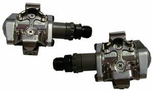

    Can you see them here?

    Those are just pedals... the "pontoons" are probably a piece that adapts the 2 hole cleat to a 3 hole shoe and in effect recesses it on a road shoe. My Crank Bros pedals (even the road specific ones) use a similar system so that all of their pedals and cleats are compatible. My cleats come mounted on a 3 hole adapter and a U shaped piece of plastic snaps over that.
