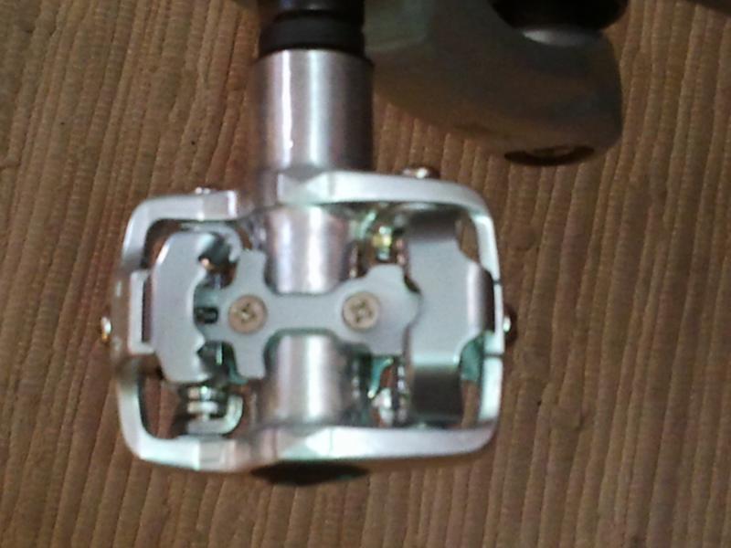

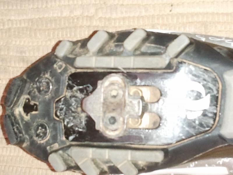

    I'm using a regular shimano mtb pedal (not sure which model) and spd clip. I adjusted the float again.. actually took the screw out and put it back in to make sure I was on the last click.
Name:	2012-02-20 10.14.45.jpg
ID:	14208   Click image for larger version.
Name:	2012-02-20 10.15.28.jpg

    Pixie - do you know for a fact that the pedals are the same that you use in spin class? Have you checked for sole interference? Are you positive the recommended cleats are the same for both pedals?
    It depends on the cleat whether old/new makes it easier to clip in/out.
    Get your shoes into the pedal somehow, remove your foot and then turn the pedal over and look for interference from the sole. If this is the case, there are spacers avaialable or you can get out the old Dremel tool and do a little remodeling of the lugs.

    That sure doesn't look like a Shimano pedal from the picture. Are your cleats shimano? SH51 on the bottom? or Welgo's WP98?
    Shim pedals often will be at the tightest setting out of the box.
    Also like SadieKate says...we occasionally will run into the sole of the shoe bottoming out against the pedal before the cleat fully engages.
