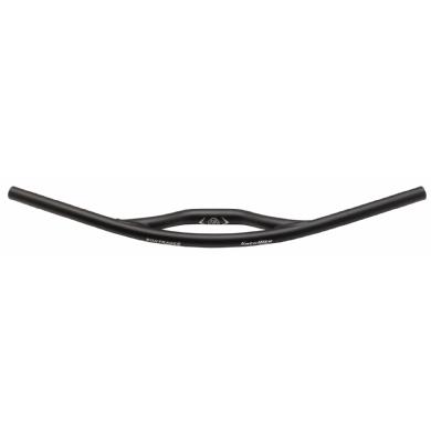

    I was looking at trekking handlebars, I have never really seen these before, and I am a bit confused.
    There are ones that resemble the shape of a butterfly, and the only thing that makes me reluctant to get those is that I think I would have to redo my whole system, new shifters/brakes and whatnot.
    However I saw a Bontrager- Satellite Plus Trekking 25.4 and Bontrager-
    Satellite Elite Carbon Trekking handlebars.
    It says that these give you many hand positions...but I do not understand how these give you more hand positions?

    2,841
    I don't see how that would give you all that many more handlebar positions either.
    However, you can put trekking handlebars on your bike without having to get new shifters or anything like that.
    Here's an example:
    http://forums.teamestrogen.com/showthread.php?t=30740
    I did learn in my research that Trekking bars are HUGE - as in very wide. This may not be an issue for you, but as I have a quite short reach and have narrow shoulders this led us to go for riser bars instead. I would have loved them, but there you go. They do not appear to come in a range of sizes either.
    The Soma Sparrows were of interest, but they wouldn't work for me either as they require a single shifting/brake "pod", so to speak, and those are not available for cantilever brakes. Otherwise there is limited space for hands...
