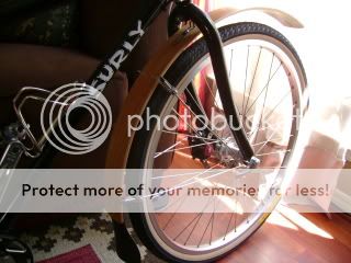

    Custom fenders girl. Thats what you need Get them made for the biggest tire you can imagine using and then a smaller tire will work fine too.
    These were custom made (by Sykes) for my 1X1s 26 inch wheel (with a touring tire). Just be sure to tell the maker exactly what tire you're using, what brakes, space between the tire and frame, type of bike etc. Then they will be EXACTLY what you need Here is a link to the special fitting section of my fender maker's website. This explores other more complicated issues than you have, but worth a look.
