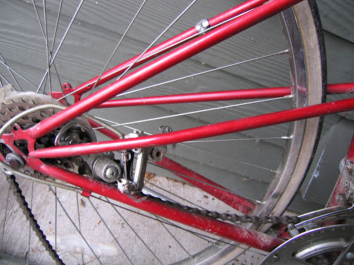

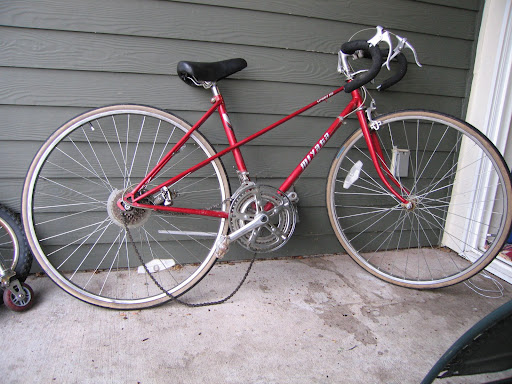

    DS left his lunch at home today so I had to take it out to him. On the way, I again spotted a mixte that's been abandoned in a drainage ditch in front of an empty lot(popular dump site). It's been there for the last month or so. After dropping off DS's lunch I had to stop to check it out. Well, it's definitely not ridable now, but I'm wondering if it may be salvageable. My only concern is that the middle stay on the drive side bends out a bit. Dh is not sure but he thinks it may be intentional so that there's clearance for the chain. Anyone here have a Miata mixte who may be able to enlighten me if it supposed to be that way?

    If it were meant to be straight and was now curved, there would have to be another bend or damage somewhere else to compensate for the longer path between downtube and dropout. Besides, most unintentional bends leave a crimp in the tube or damage the paint. An inward bend would make far more sense than an outward bend if it resulted from an accident. Good chance the bike was made with that curved tube.

    I hope so too. I've wanted to get a project bike like this for awhile and the frame is my size. How's that for a coincadink???
    Here's a link to more pics:
    http://picasaweb.google.com/sgtiger3/Miyata

    Oh my, do you think someone intentionally bent it due to the current location of the RD?

    Not much more to add....looks like a neat bike, and what DebW said sounds reasonable to me.

    Oh...meant to ask...what is that on the left seat stay??
    p.s. one other edit...if in doubt...bring the frame to your LBS and have them check it out.
    pps...okay, another edit....on your picasa site, you can see the chew marks on the paint inside the stays where the derailleur did its damage when it got sucked up and wrecked. I hope that didn't cause a problem...

    It obviously needs a new rear derrailluer, and it's missing it's rear brake, but it doesn't look terrible otherwise.
    The bracket on the rear stay may have been for a reflector.

    That bend is intentional. On another bike forum a bunch of us compared our late 80s mixtes (from just before bike companies stopped making them) and a lot of them had that bent stay. I think it's a little ugly and the earlier ones are much prettier (they have a lug further up that sets the stay out far enough to clear the cassette), but it doesn't seem that it makes the frame structurally unsound.
    One of my two Nishikis is like that. I confess that it's the one I never built up or rode, because once I noticed the bent stay and some cosmetic scratches on the frame I wasn't very interested in it. But I don't think it makes the bike unrideable.
