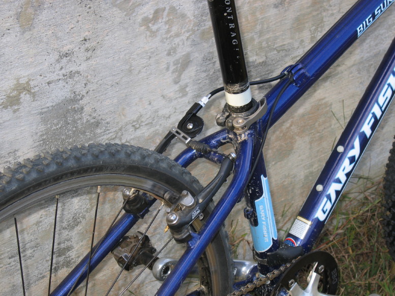

    I have V-bakes on my newly-created Frankenbike. When we first changed over to the Shimano STI levers the brakes were very mushy and did not feel safely rideable. Since adding the Travel Agents they seem to work fine. They go for 15-20 dollars each, though, so it might be just as good to change over to the cantis. I wasn't able to use cantis on my frame 'cause there wasn't any room for the part that attaches to the seat tube.
