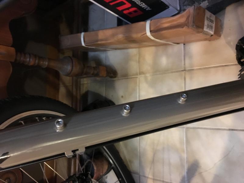

    My beautiful new Ogre is studded all over with braze-ons. I know what a braze-on is -- a predrilled hole in a bike frame to attach racks, packs and accessories. But I don't understand how they do what they do. I've Google-searched "how do braze-ons work" and variations thereof, but it was no help at all. Apparently this is something I'm supposed to already know.

    I thought the silver cap might screw off like a cap nut, but no. Do you drill the screw right through the cap and mount, say, a bottle cage that way? I'll probably take it to my LBS for any big attachments, but I'd hoped I could at least mount the bottle cage on my own. What do you suggest?

    It should unscrew with an Allen key, no? Then the holes in the water bottle cage should line up with the existing holes, and you screw the bolt back in. Unless this is some totally new system. I'm pretty sure you don't want to take a drill to your new bike.

    Yeah, it’s a hex head mounting bolt. Having a quality light weight multi-tool (Park, Lezyne etc.) that has at least 4,5,6mm hex wrenches in a saddle bag ftw

    Thank you all very much! It's the simple solutions that always elude me.

    and i forgot to say it's 4mm on the ogre so you can either get a 4mm allen/hex key or a multi-tool with one.

    rebeccaC: I had a Park multi hex wrench on order from Amazon -- three LBS were out of stock on them, go figure. It arrived just in time for me to triumphantly (and correctly, I trust) attach a bottle cage. Yay me!

    4 mm hex wrench is the size you need. Sometimes they are tight - which is what it sounds like for you. Put some muscle - lefty loosie, righty tightee
