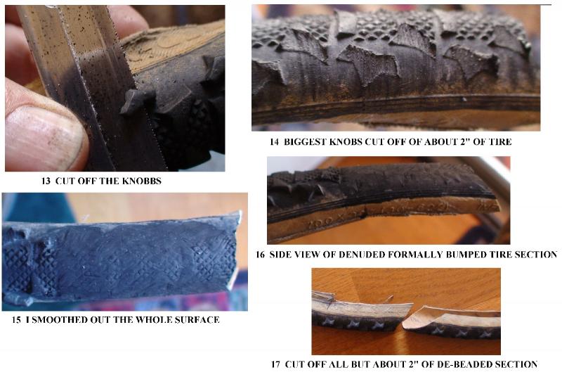

    Cut off all but around two inches of the soon to be denuded bumps tire section. Trim the bumps off the inside tube (the section without the bead now) using the model saw or Xacto or whatever you want. You only need to trim the bumps from a couple of inches. You could get away without trimming anything but it makes for a better fit. Then, if you are a bit of a perfectionist, flatten out the remaining bits with the Dremel. Photos 13 - 17 Click image for larger version.

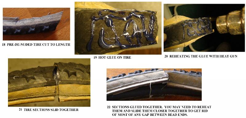

    Fit the two ends together so that the two sets of cut bead ends touch. Then, glue the two ends together using hot glue. Hot glue is great because it can be remelted if you make a mistake and stays flexible. I just put hot glue on the denuded tread and then reheated it with the heat gun before fitting the tire sections together again. Photos 18 - 22 Click image for larger version.

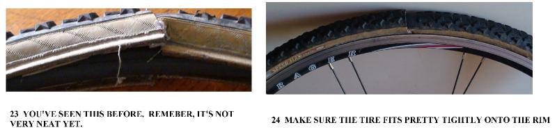

    Put a 650c tube into the incomplete tire and fit it onto a 650c rim. It's not very neat looking, yet. Make sure the bead is inside the hooked rim and inflate the tire with about 10 lbs. pressure. If it's too loose, then take it off, reheat it and slide the two sections together more tightly. You may need to cut some bead off if you made it too loose to start. Photos 23 - 24 Click image for larger version.

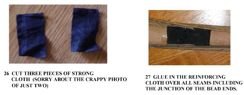

    It fits OK. Deflate it, remove the tire and tube. reinforce the seams using cut pieces of nylon cloth (or cotton or whatever) glued into the inside of the tire with the Barge cement. Cover the seems at the butt ends of the two beads and the end of the tire overlaps. Photos 25 - 26 Click image for larger version.

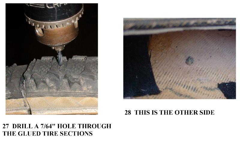

    Take off the tire, remove the tube and drill a single hole through both sections of tire using the 7/64" bit. Try not to drill your hand. Choose a point maybe 1 inch back from the cut end of the top section and in between the bigger knobs. Photos 27 - 28 Click image for larger version.

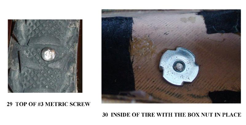

    Now, the trickiest part. Take the short #3 metric screw and screw it into the hole. The screw should be just long enough that the end begins peaking out of the inside of the tire. Then, line up the box nut with the screw end and tighten the screw. You may need to do the lining up by touch - you should be able to feel when the box nuts end is on the top of the screw end. Tighten down the screw. As you do that, the sharp tangs will embed into the tire. This makes a really sturdy seam that won't separate. I then added a drop of Barge to the end of the screw to make sure it will never loosen up. Photos 29 - 30 Click image for larger version.

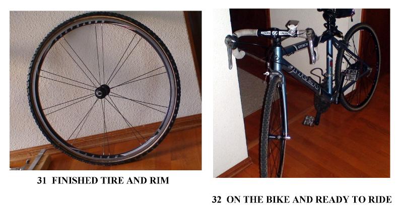

    My wife has used these for commuting and cx and they work great. The only little irritation is that the tires make a sound every time the seam passes over the ground. Any bump is minimal. See the rest of the photos. Click image for larger version.
