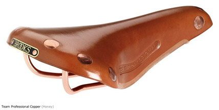

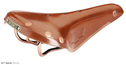

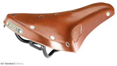

    But just out of curiosity, I'm gonna line up all the saddles discussed so our eyes can do the judging. Measurements off www.brooksengland.com
    B17 Special:
    Width: 170mm
    Length: 280mm
    B 17 S:
    Width: 177mm
    Length: 245mm
    Team Professional:
    Width: 160mm
    Length: 260mm
    Team Professional S:
    Width: 170mm
    Length: 245mm
    Fitness:
    Width: 170mm
    Length: 245mm
    Who knows how they decide to measure the width saddles, but there's definately a difference in shape.
    Speculations...

    Ok, that whole post had pictures of the brooks saddles.... it worked just fine on the preview, and had to be "approved", which took two days. How frustrating.
  5. #20
    Apr 2008
    3,176
    I can see the pics when I swipe the URL from properties and then paste it in the browser address line.
  6. #21
    Apr 2008
    3,176
    Curiouser and curiouser, now the ones I looked at in a new window are showing up in your post.
