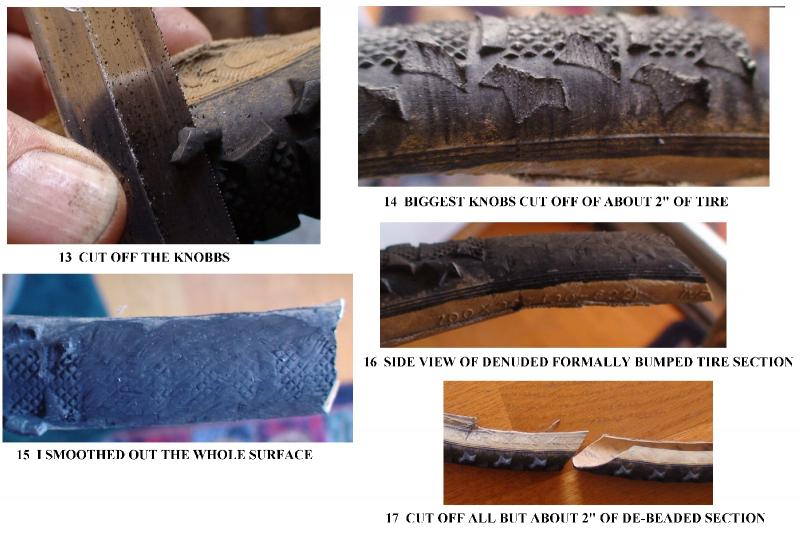

Cut off all but around two inches of the soon to be denuded bumps tire section. Trim the bumps off the inside tube (the section without the bead now) using the model saw or Xacto or whatever you want. You only need to trim the bumps from a couple of inches. You could get away without trimming anything but it makes for a better fit. Then, if you are a bit of a perfectionist, flatten out the remaining bits with the Dremel. Photos 13 - 17 Attachment 17873

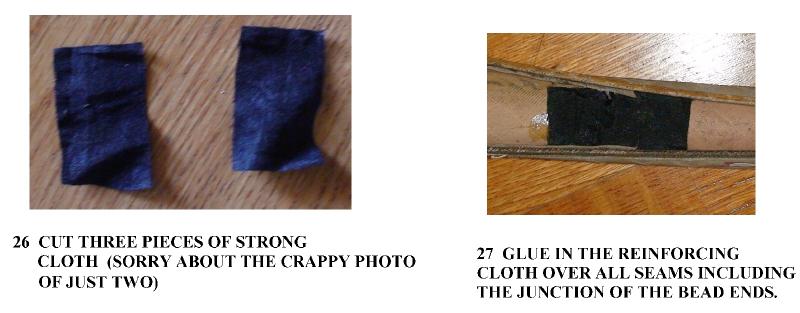

It fits OK. Deflate it, remove the tire and tube. reinforce the seams using cut pieces of nylon cloth (or cotton or whatever) glued into the inside of the tire with the Barge cement. Cover the seems at the butt ends of the two beads and the end of the tire overlaps. Photos 25 - 26 Attachment 17876
Let the glue dry for an hour or so. Use the spare time to try and remove all the glue from your fingers. Good luck with that. Then, remount the tire onto the rim and verify it fits. Inflate the tire again to maybe 15 lbs. The expanding tube will help set the glue. Let it sit for maybe 10 minutes like that.
