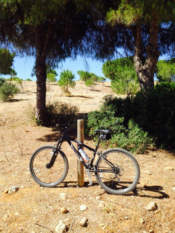

I am a roadie at heart, that wanted to try mountain biking since I plan to retire to an area with a lot of dirt roads and MTB trails (southern portugal). So, I bought an older used MTB (2005 Gary Fisher Tassajara) that was in great condition (barely ridden) since it had English threading and would work with my custom crank sets (that correct for a 2.2 cm LLD I suffered in a cycling accident many years ago). For the trip, I installed my road crankset with the 34 tooth chain ring attached (w rear 11/34 9 spd DeoreLX drivetrain), which gave me a range of 30.6-68.9 gear inches. Now its time to finalize the gearing on my custom MTB cranksetAttachment 17333Attachment 17334Attachment 17335Attachment 17336Attachment 17337. The terrain in Portugal where I plan to retire was more mountainous than I expected, and since I felt like I was lacking much more on the low end than high end, I am thinking to get either a 22/38 (16.8-89.6 ) or 24/40 (18.3-94.3) leaning towards the 22/38. Does that make sense to you guys? It’s a heavy bike (30 lb) w 26” wheels, and while I love cycling I am not a strong rider (even my road bike has a 50/34, 12/27, 650c wheels and gets me up moderate but not super steep climbs). Will this gearing still work if someday I decide to upgrade to a more modern lighter MTB? I know I can always order new chain rings in the future, but since they are custom made to fit me they aren’t cheap so I would like to get it right the first time.
