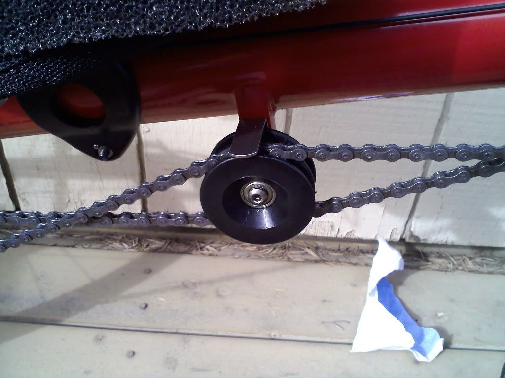

Here's my question: The chain is incredibly long, and as a result sags something fierce. The Xtracycle web site doesn't have very helpful information about dealing with chain sag, unfortunately. After trying to use a chain tensioner but not having that work, my bike shop guys put an orange roller thing to hold the chain up, as you can see here:
http://farm4.static.flickr.com/3470/...b1a89af92c.jpg
http://farm4.static.flickr.com/3579/...6a389e78b4.jpg
The problem with this is that as I get into the two highest gears (smallest cogs on the cassette) from the middle chainring, the chain falls off the orange roller. It fell off three times in a 15-minute ride and six times on my normal 13-mile commute. Then I have to stop, flick it back on, and go on. This is incredibly irritating, especially since I don't have an indicator to tell me what gear I'm in, so I can't always tell I'm in a dangerously high gear. Also it always happens when I'm going at a decent pace, usually down a hill, which is just when I don't want to have to slam on the brakes, twiddle with the chain, and then have to muscle it to start again since I'm in a high gear. Plus I live in fear of shifting and hearing it fall off; the other choice is to stay in too-low gears and spin like crazy, but I end up going frustratingly slowly in that case. I'm not usually in a hurry, but I would like to keep up a comfortable, sustainable pace, rather than going at a much lower speed.
So: Do you clever wrench-types have any suggestions for what else we could use to suspend the chain partway along? I'm especially interested to hear how other Xtracycle riders have dealt with this problem.
