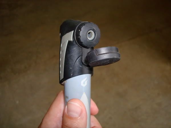

Here's the mini pump. This head is set for a presta (skinny) valve, so I need to change it for schrader.
http://i5.photobucket.com/albums/y18...crew/pump2.jpg

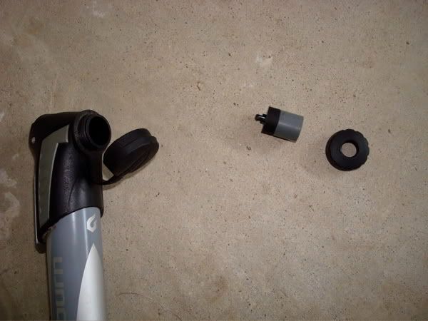

I unscrewed the outer black ring and pulled out the presta adapter.
http://i5.photobucket.com/albums/y18...crew/pump3.jpg
This is the presta adapter and I'll need to reverse it for the schrader.

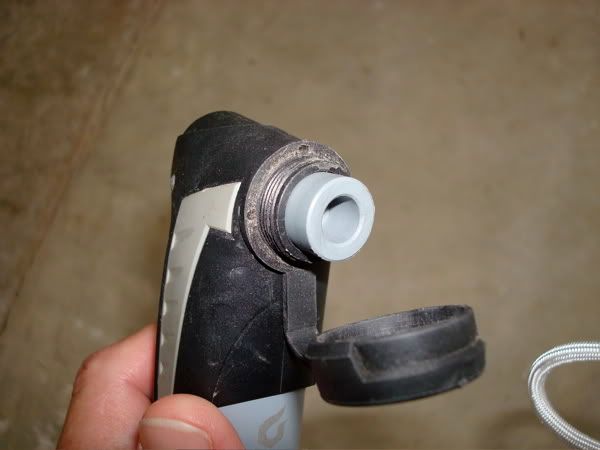

I've set it for schrader and I need to screw the black ring back on the pump at this point.
http://i5.photobucket.com/albums/y18...crew/pump5.jpg

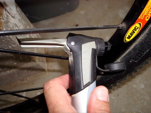

Now I'm attaching it to my valve. Notice the lever is in the down position. Press the pump down firmly until you feel it "give".
http://i5.photobucket.com/albums/y18...crew/pump6.jpg
Now pull up the lever and it should lock it into place. Now you can start pumping up your tire. :) Be very careful to not jiggle the valve too much so as not to break it. ;)
